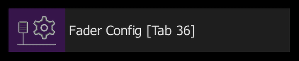

Fader Config [Tab 36]
This display allows you to edit the settings of your pages of virtual faders.
Fader Config can be opened in a standalone tab from the Workspace Layout Menu or by using [Tab] & [3][6].
